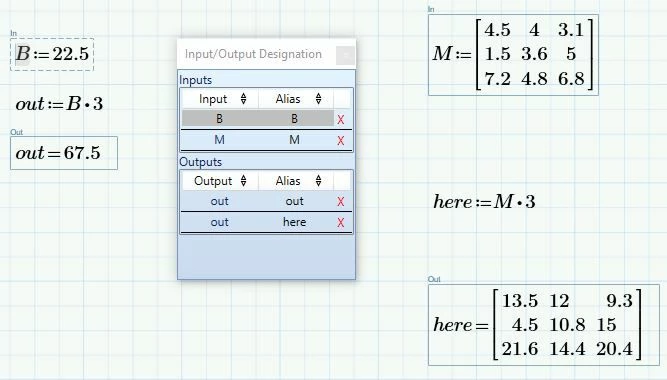

  1. Is there any database used by MC15 or MCP?'
MCP has a "database" of input and output regions declared in a worksheet.  Each input output has an "alias" in the database used to communicate data.  You can manually change the names of aliases.
2. What are the interfaces / APIs available to integrate with a custom solution?
Two file are included in the Prime distribution
Ptc.MathcadPrime.Automation.dll
Ptc.MathcadPrime.Automation.tlb.
Using Visual Studio 2017 Community you "add a reference" to a project.  Select Project | Add a Reference.  select the COM section from the left hand menu.  Use the Browse button go to the Mathcad Prime distribution and select the dll file.  This will add the dll and tlb to the project and more importantly gives you intellisense on using the classes in the IDE and the classes are available in the object browser.

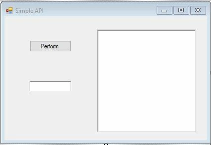

3. What language these APIs are developed? Are there any C# .Net interfaces available?
You can use in Visual Studio 2017 Community either Visual Basic or C# to program.  Enclosed here is the visual C# that inputs and outputs to Mathcad both doubles and matrices of doubles

private void button1_Click_1(object sender, EventArgs e)
var appCreate = new ApplicationCreatorClass();
ApplicationCreator app;
app = (ApplicationCreator)appCreate;
IMathcadPrimeWorksheet3 ws;
ws = (IMathcadPrimeWorksheet3)app.Open(@"D:\\Prime\\VB\\Test.mcdx");
app.Visible = true;
double output;
IMathcadPrimeWorksheet wsTest = app.ActiveWorksheet;
ws = (IMathcadPrimeWorksheet3)wsTest;
wsTest.SetRealValue("B", 22.5, "");
IMathcadPrimeOutputResult resolve = wsTest.OutputGetRealValue("out");
output = resolve.RealResult;
textBox1.Text = output.ToString();
int i = 5;
IMathcadPrimeMatrix matrixValue = (IMathcadPrimeMatrix)ws.CreateMatrix(3, 3);
i = matrixValue.SetMatrixElement(0, 0, 2.5);
i = matrixValue.SetMatrixElement(0, 1, 4.0);
i = matrixValue.SetMatrixElement(0, 2, 3.1);
i = matrixValue.SetMatrixElement(1, 0, 1.5);
i = matrixValue.SetMatrixElement(1, 1, 3.6);
i = matrixValue.SetMatrixElement(1, 2, 5.0);
i = matrixValue.SetMatrixElement(2, 0, 7.2);
i = matrixValue.SetMatrixElement(2, 1, 4.8);
i = matrixValue.SetMatrixElement(2, 2, 6.8);
ws.SetMatrixValue("M", matrixValue, "");
IMathcadPrimeOutputMatrixResultAs hereResult = ws.OutputGetMatrixValueAs("here", "");
double wshereResultRowsCount = hereResult.MatrixResult.Rows;
double wshereResultColsCount = hereResult.MatrixResult.Columns;
double dblhere;
for (int ic = 0; ic < wshereResultRowsCount; ic++)
for (int jc = 0; jc < wshereResultColsCount; jc++)
hereResult.MatrixResult.GetMatrixElement(ic, jc, out dblhere);
richTextBox1.AppendText(Convert.ToString(dblhere));
richTextBox1.AppendText(", ");
richTextBox1.AppendText("\n");
((IMathcadPrimeWorksheet3)ws).Close(SaveOption.spPromptToSaveChanges);
System.Runtime.InteropServices.Marshal.ReleaseComObject(ws);
app.CloseAll(SaveOption.spDiscardChanges);
app.Quit(SaveOption.spDiscardChanges);
System.Runtime.InteropServices.Marshal.ReleaseComObject(app);
System.Runtime.InteropServices.Marshal.ReleaseComObject(appCreate);
4. What would be the cost of SDK? and is it a bulk license or one license per developer?
Why spend the $9k for the examples.   The intellisense feature of Visual Studio and the object browser gives you all the classes etc.  Above is a simple example that works.  There are a number of other examples available in this forum and on the www.
