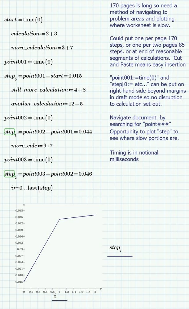

I have a legacy calculation converted from Mathcad 15 that is mathematically very simple but approximately 170 pages long and as you will see from the attached is butchering my cpu.  The aforementioned Prime calculation is consequently running painfully laggy and occasionally crashing.
Does anyone have any recommendations on a sensible procedure for processing such conversions that goes beyond the standard PTC Mathcad Migration guide?
For example, is it advantageous to break the calculation up into areas and disable them etc...

Well done to get the size down.  By sections I mean insert the "point###:=time(0)" and "step[0:= etc.." by page 170 steps, or two pages at a time 85 steps,  or reasonable calculation steps.  Keep the file as one item.
This way a plot of timing in each step can show where to concentrate some effort in speeding up worksheet..

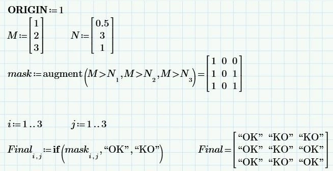

If you are doing the same thing over and over try and vectorize it or use matrix arithmetic.
For instance the top truth table in matrix comparisons would be faster than the if statement.

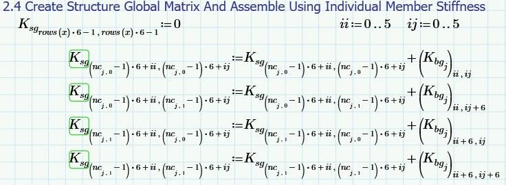

Matrices - define the last element first as this avoids Prime resizing it.
Avoid for loops and use indices instead of programming.
For example large matrix first and indexing using range variables instead of for loops in programming.
