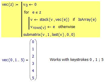

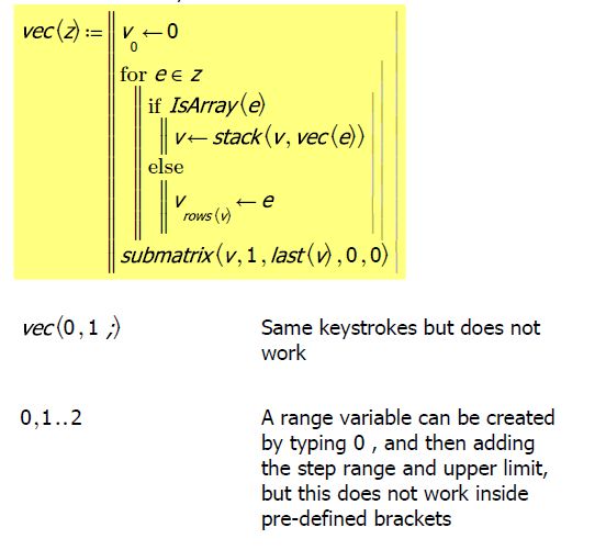

I have just brought a user defined function 'vec' into Prime which takes a single argument and converts to a vector i.e. a range variable. However, I am having an issue typing a range inside pre-definedbrackets.
In Prime this does not seem achievable.
I must be missing something here!!!

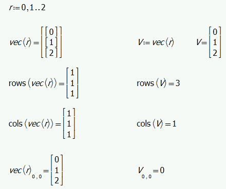

And the second in Prime:
Jun 19, 2014 6:58 AM UTC
Returning vector a individual nested elements??.

I will. Valery shown a range can be defined and then passed to the function, but again, this is only a workaround.

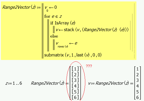

There is more than just 1 issue!
Not being able to enter a range inside a pair of function arguments parentheses is just one and the minor one I guess. I also quite often happens that Prime will refuse to paste a copied expression (like a cpmplicated function name) at some place, while it will at least allow to retype it there - thats quite annoying and gives the impression of a rather ill-conceived program.
The more severe bug is the different behaviour whether an expression is evaluated on its own or if it is assigned a variable. This is truly very bad! Valery shows this in his second post but it can be also duplicated with the routine in his first file:
