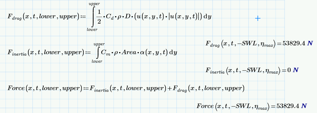

My company has recently gone over to Mathcad Prime due to most of our employees only needing to do basic calculations but I tend to need to use it for a wider range of uses but I still need to be using the same version as everyone else
At present I am working on a wave loading worksheet and need to integrate between two points to obtain the force on an object but I keep getting a message saying that it can not converge (even though it can solve the parts of the integration individually)
Naturally I tried to see what options I had and I noticed that I had the multithreading enabled so I thought I'd turn that off and now it can solve the worksheet. Then tried turning it on again and it couldnt solve the equation, then on and again it solved it
My question is what is going on with the multithreading and how it affects what it does when it integrates an expression?
I know multithreading allows use of more of the computers cores and lets multiple equations be solved at once but it also seems to prevent the mathcad from solving some integrations. (as it was able to solve some, but not others)
What other functions can't be used when you have multithreading enabled and what kind of mathcad sheets was multithreading designed for?

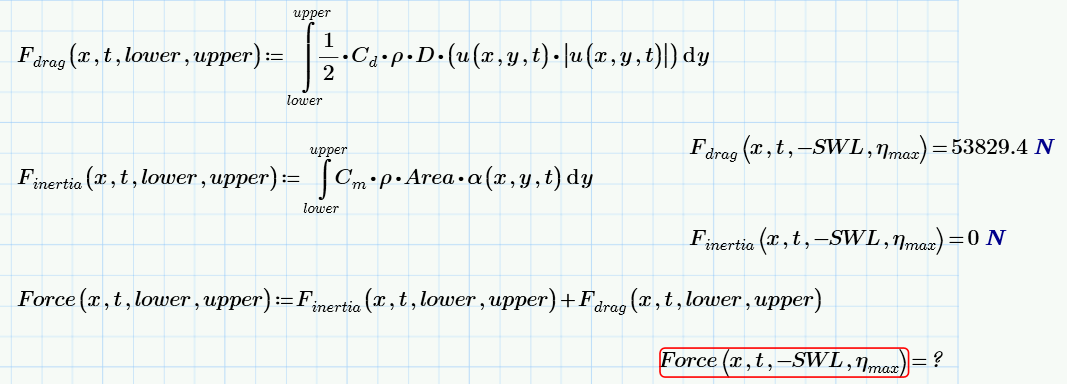

Unfortunately I wont be able to upload the sheet itself because of the content but it is basically the stokes wave theory (obtained from Fenton) to obtain velocities and accelerations of particles and using the Morrisons equations to integrate between the seabed and crest elevation to obtain a wave loading
Below is a screen shot of what happens though:
With multithreading on:
With multithreading disabled:
Oddly enough, it gave a new error saying units werent compatible... not had that one before, usually it just says the converging error, but whatever the error says, it still is an error when I have multithreading enabled

and a new error using the multithreading enabled:
Guess what the error message keeps changing (Moment is also an integrating equation but it is also multiplied by the distance).
hence why I asked my original questions, why can't it seem to solve a sheet when multithreading is enabled even though it can solve it when it is disabled
Jun 19, 2014 10:50 AM UTC
Looks like you found a bug you should report to PTC support!
