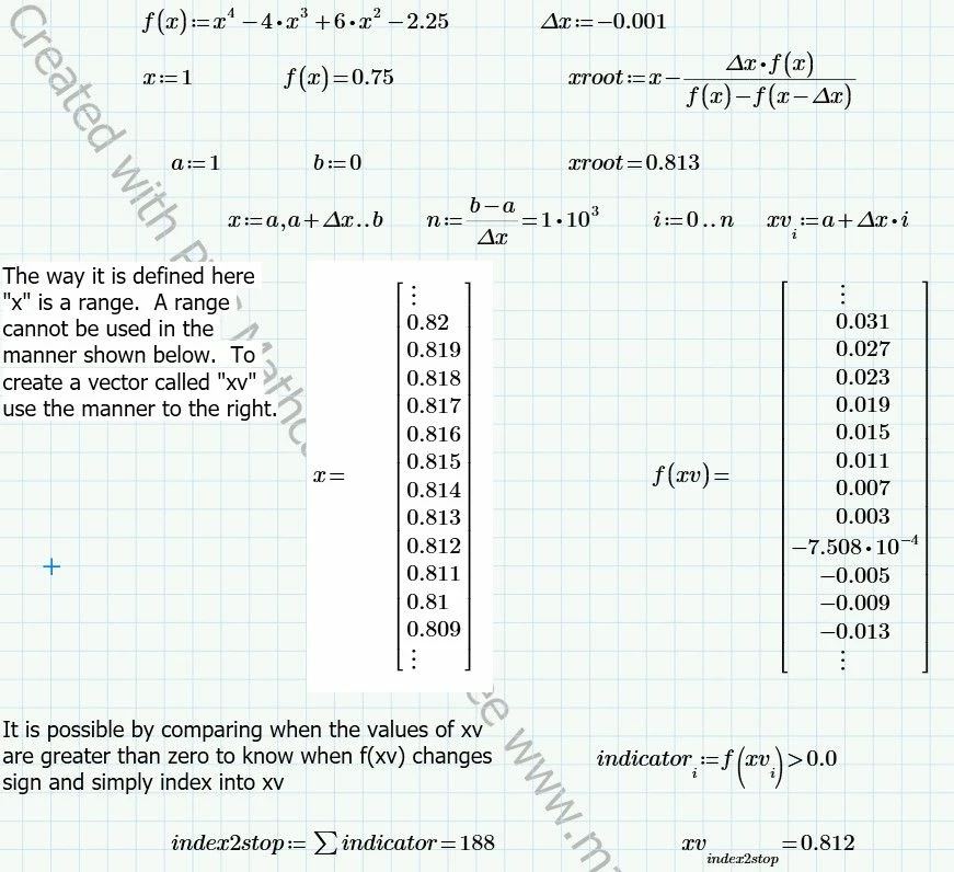

Hi experts, newbie here. Is there a way for me to program this, where when f(x) changes sign, it automatically stops solving.

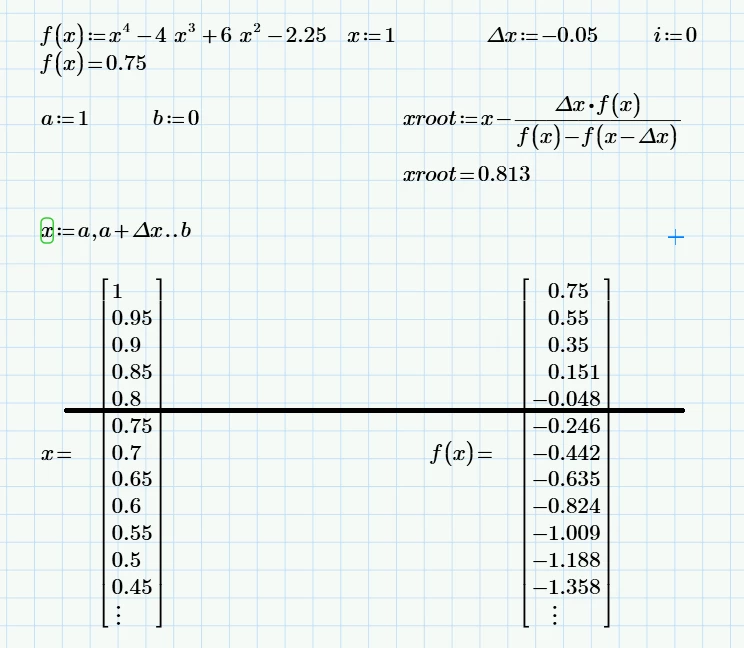

Using Express version so cannot use programming but it only takes three steps to get what you want.
Try Deltax at -0.001 as test.
Cheers

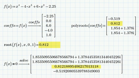

Are you asking this for a specific reason?
I guess you know that you can solve for the zeros in various ways - here a few ways:
