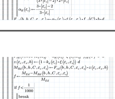

Is there a way to ressign the values to a variable in mathcad programming?
For example Es is 2.175 and Ec is 3.5 in a loop. Ec is fixed here and iterate Es until MEd is almost equal to MRd. If it doesn't happen then change the values of Es to 25 which is fixed and Ec iterated from 0 to 3.5 until MEd is almost equal to MRd. How to write a Mathcad program without repeating the steps.

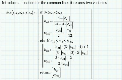

hI,
Replace the common lines by a function.
Example is used for three instances of common lines,
Their replacement in major program highlight in the third instance what could be a mistake in following lines.
First Use:
Second Use:
Last Use which might highlight a msitake in following lines
Cheers
Terry

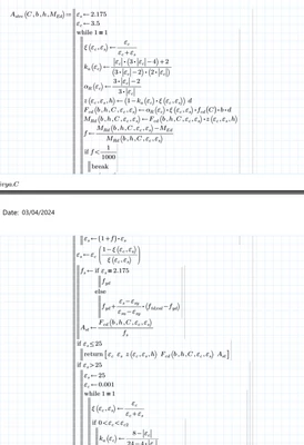

Jun 28, 2024 3:59 AM UTC
Hello dear Terry,
here is the Mathcad sheet, which i am working on.

hI,
First Use:
Second Use:
Cheers
Terry
