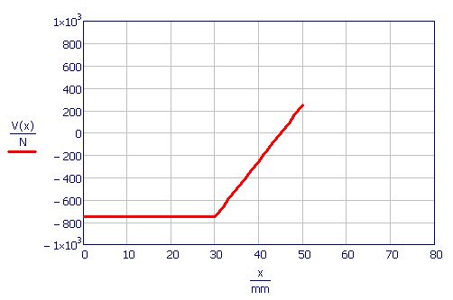

i am trying to program some functions to plot the shear and force diagram.
I have no problem entering Units on the Y axis, but as soon as i input units on the X axis it doesn't work.
Is there a limitation that doesn't allow X axis to have units?
see the program attached,
May 19, 2011
Have a look at the attached. I have defined x as a range variable and it works.
Mike
May 19, 2011
Mike
May 19, 2011
If all units are remove the function works as you had it set up.
Mike
May 19, 2011
Same as in Mathcad 15, range variable needed.
Mike
