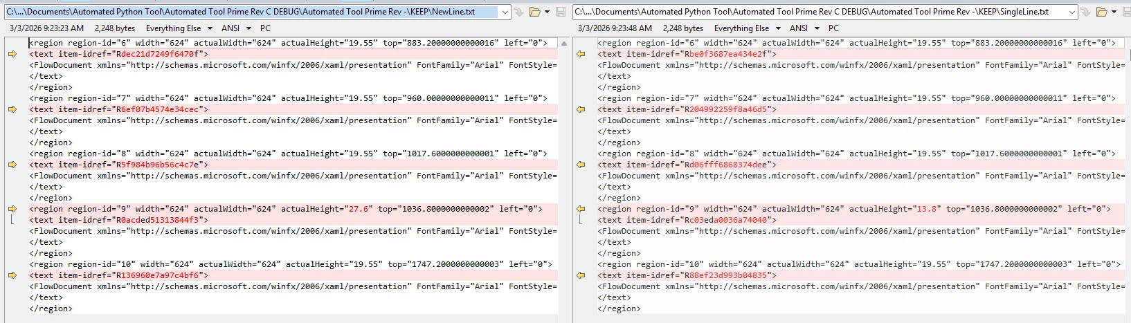

6-Contributor
Mar 3, 2026 2:29 PM UTC
I also did a BeyondCompare of two Mathcad Prime XML files. The file on the left has a new line in the text region and the file on the right does not have a new line in the text region.
The actual height is larger for the file on the left since it has the new line, but otherwise everything else is the same.
I see the text item-idref is different between the two files. What is that used for? Is that where text data in the actual Mathcad Prime files is stored?
I am not a software person so excuse my ignorance,
