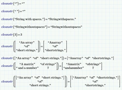

LucMeekesAnswer
23-Emerald V
Apr 29, 2024 6:59 AM UTC
Ah, you want the function to just return the value if it's non-string. That can be done,
Being a version that runs in express, it is necessarily a oneliner.
I've enhanced it to allow arrays (vectors, and even nested, matrices), and it now requires no second parameter.
With so many oneline solutions, I propose you add another property to the table: runs in express.

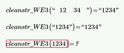

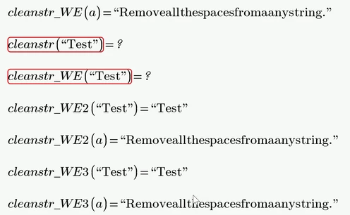

How about a 1-liner ?
But, as you can see in the sheet attached, my 1-liner suffers from the same problem as your function - it fails if the string does not contain any spaces.
That's a bug which can easily be fixed by using a "try...on error..." statement, But now the new function is four lines high 😞
EDIT: OK, the third attempt "cleanstr_WE3( )" now is a 1-liner again even though it deals correctly with strings containing no spaces.
This last function still has a drawback (that the second version "cleanstr_WE2( )" does NOT suffer from) and can fail, but I leave that as a challenge for you to find out when and why 😉
As nobody else has answered so far, I simply attached the new file (format P9) containing all three of my attempts in a collapsed and password protected area with a time stamp.

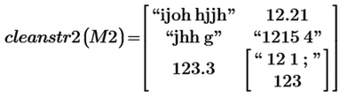

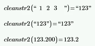

Perez14-AlexandriteAuthor
Apr 28, 2024 8:38 PM UTC
If "cleanstr_WE3( )" is a 1-liner, then it is working great except when the string is not a string. I think inside a "try..on" statement will become a 4-liner.
I have corrected the original version but now it became a 10-liner:
Note: Attached prime 9 worksheet (still password protected until the challenge has a winner. Potential winner: Werner_E )

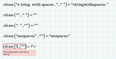

23-Emerald V
Apr 28, 2024 10:00 PM UTC
Mine is a one-liner, with the requirement that it (necessarily) takes two arguments, the second argument is a string (any string). But it runs in Prime express.
It has the following behaviour:
I cannot hide it in a password protected collapsed area, so will not disclose it yet.
What I do know is that you can build it into a two-liner for full-Prime, where it then requires only one parameter, the string itself.

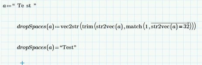

I'll bite.
One liner in Prime full version.
Utilizes a trim function that is only availanble in full Prime
Uses a truth table to sort the vector of ASCII codes.
Not interested in password protecting it.
Cheers
Terry

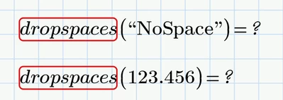

Apr 28, 2024 11:04 PM UTC
Similar to my first attempt with similar flaws 😉
BTW, you may simply use  match(32,str2vec(a))  to get the index list for the trim command.

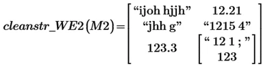

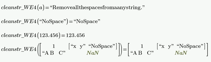

OK, here is a 1-liner which also deals with non-string arguments.
The next step would then be a function that handles the input recursively and removes the spaces in all the strings it contains, but leaves the nested structure intact, so that the result in the last example would look like this:
BTW, this fourth attempt still suffers from the same little flaw as the third one.
The most stable so far is the second one which also correctly dealt with non-strings, but because of the used "try ... on error" takes up four lines.
Apr 28, 2024 11:50 PM UTC
Below is the updated summary so far:

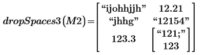

Apr 29, 2024 1:39 AM UTC
herewith is one liner with testing.  dropSpaces2(a)
Can handle data besides strings
Can handle string with no spaces,
Can handle string of any number of spaces only,
Can be applied element by element to a matrix.
Cheers
Terry

After a thorough and insightful review of all submissions, the moment has arrived to crown the champion of this Mathcad challenge. Selecting the winner was as intricate as solving a complex equation, but ultimately one submission met all our criteria with exceptional finesse.
Congratulations to @LucMeekes ! Your function cleanstr(str) not only seamlessly handled non-spaces and non-strings, but it also gracefully managed nested matrices and compatibility with Mathcad Express. Your code is like a master key for Mathcad users, unlocking efficiency and simplicity in one fell swoop!
