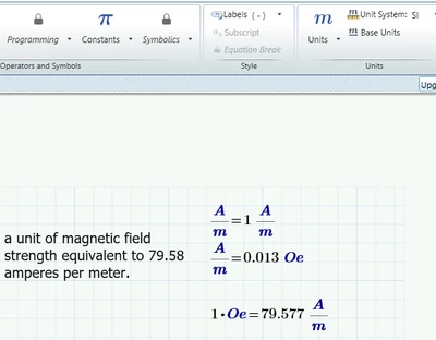

Why is Oe in the SI list?  The modern developed unit is H in A/m.
April 13, 2021
A/m is not ONE unit but a combination of two. So you won't find it in the unit list. You also won't find m/s when you look for speed units, but any speed will be automatically shown in m/s.
You can always type in A/m yourself as you like.
And results are displayed in A/m anyway. So I can't spot any problem.

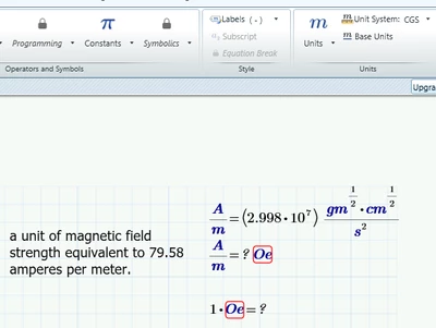

So you are technically correct, Oersted is not SI.  Prime 4.0 Express with CGS unit specified.  (Built-in unit not specified?:
With MKS specified

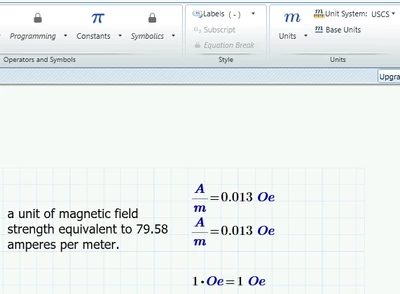

And with USCS specified:
So Prime has issues with units.
