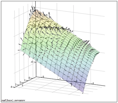

I came across this vector field plot that MATHCAD 15 was able to plot and I found that the latest PRIME versions do not have such a plot type.
I am pretty confident that someone in the community made some script to replicate such a function.
I already saw some attempts made in other threads. However, they work for 2D vector plots.
Any chance that someone did for the 3D vector plots as well?
I am showing below the type of plot I am looking for.

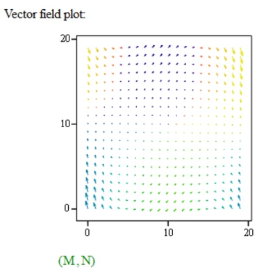

Vector field plots in Mathcad 15 were 2D plots as well, even though you would have to do it in the 3D-plot-region.
Here is an attempt I created at the times of Prime 2, but it still applies:
Vector Field Plots in 2D for Mathcad 15 and Prime
