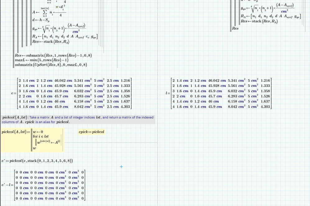

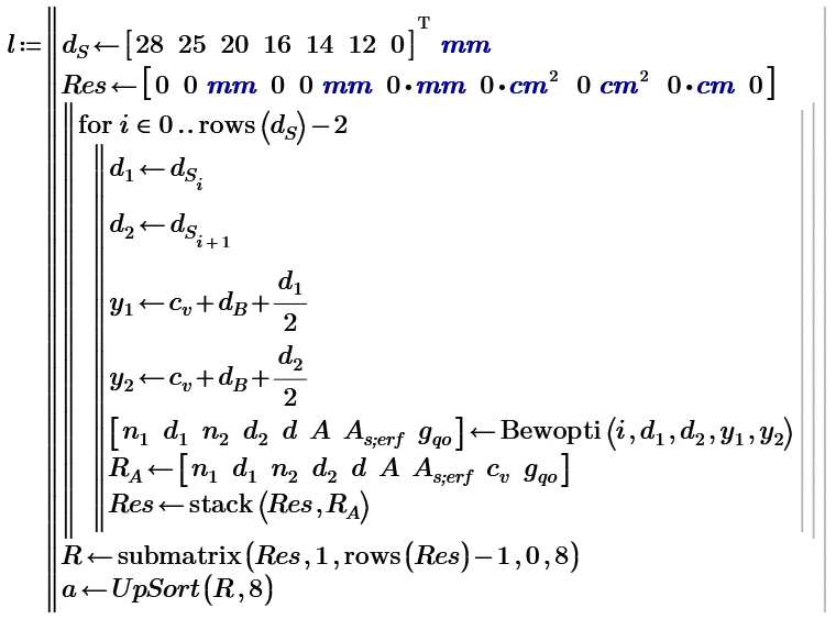

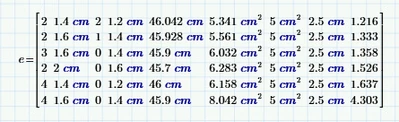

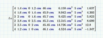

Hello everyone,
could someone explain why i am getting different answers in the programs e and l.
Is there a way to get same output from both the programs? Does it have something to do with for loops?
the output should be like program e.
Attached Mathcad 10 file.

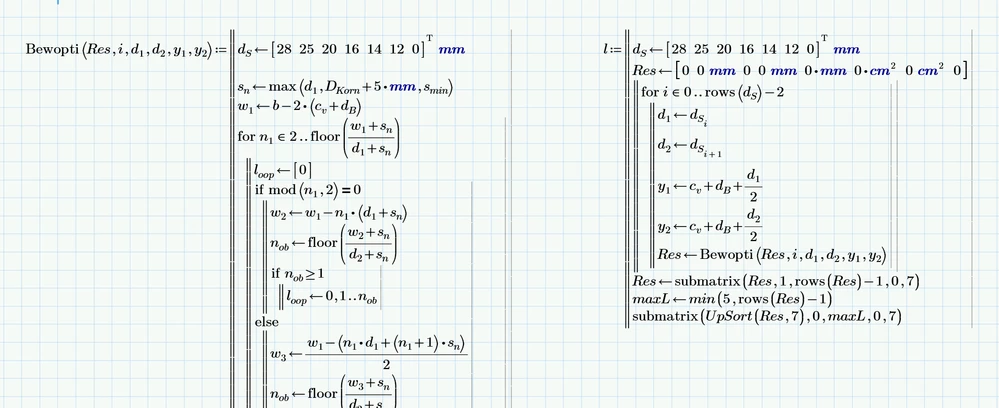

Nov 14, 2024 3:58 PM UTC
You need to include Res as an argument to Bewopti.
See attached MP10 worksheet.
Stuart

Nov 14, 2024 6:40 AM UTC
Just a note ... it is necessary to switch Page View to Draft View to see l definition on the right side.

Nov 14, 2024 10:14 AM UTC
If add Cv and change 7 to 8, then you can get same cols.

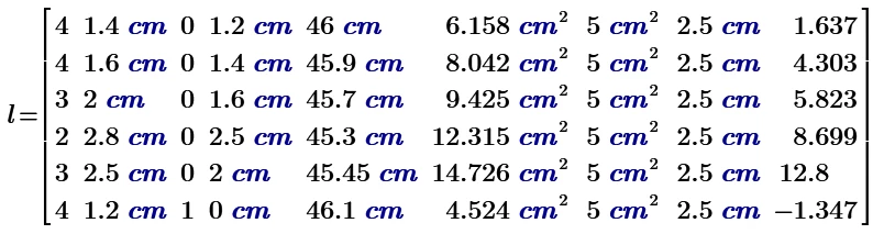

Nov 14, 2024 11:17 AM UTC
Sorry, may be you did not understand my questions. I mean all the numbers should be same in both the programs.

Nov 15, 2024 4:32 AM UTC
It worked. Thank you soo much.
