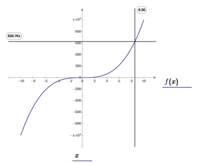

  3. I`ve been using plots from a long time and now I need my graph to display X & Y coordinates exactly at the plotting point. How to do that?

3. Use the native plot (from the ribbon 'Plots') and insert horizontal and vertical markers. Move them as you see fit, or enter the expressions:

Apr 29, 2025 12:58 PM UTC
Guess that Terry and Luc already answered your questions or asked for more information (where I would need more info as well).
According to #3 its not clear to me what you are looking for.
If you really mean to write text (coordinate values) at a specific position in the plot itself, you may give Lucs Toolbox a try -> Toolbox: Text plotting
It may take some time to get used to and to automatically place the text at positions which may change when input values are changed.
For a more elaborate example of doing so you may ave a look at Drawing a vertical line in plot

Apr 29, 2025 10:48 PM UTC
I think he means they have sampled data
Eg
x      y
1.2   1.5
1.3    1.6
3.7    2.7
Then they want the same labels on the x  axis  numbering 1.2, 1.3, 3.7 and Y axis numbering will be 1.5, 1.6 and 2.7.  Not the normal equidistant numbering. I am only guessing from the comment made.
Apr 30, 2025 12:06 AM UTC
Guess we have to wait for @SharmaKona-Adro  to reply and clarify.
If your assumption is correct, Luc's suggestion with the markers could be an acceptable solution for a small number of data points.
If there are more data points or if the number of data points needs to be kept variable, then an automated solution using Luc's text toolbox could be considered. However, I see a number of problems here, as the font size depends on the axis scaling and overlaps are unavoidable if there are too many data points.
