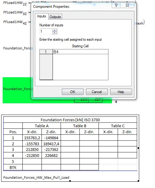

Does anybody know if there is is simple way how to assign mathcad result from matrix to excel specified cell. I got formated excel table which I want to fill in certain cells with results. I enclosed the simplified file where is easy to understand which result should go to which cell. Any tip is really appreaciatted. Thanks for help. David

You have to specifiy the input cell. See attached.

Thanks a lot Mike for answer. Just got back into this task. So you entered starting cell of the excell tabel as first input from mathcad matrix. Am I right? Capture.JPG
Oct 29, 2014 1:54 PM UTC
Yes. As 'Foundation_Forces_HW_Max_Pull_Load' is a two column four row vector it will pass all those value starting from B4.
Oct 29, 2014 2:01 PM UTC
Thx a lot for your effort. Best Regards David
