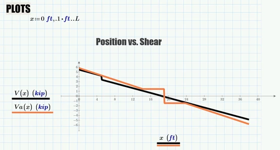

I'm using a range variable and multiple functions to plot the capacity and demand of a beam system to check for failure.  This works well and as I intend.

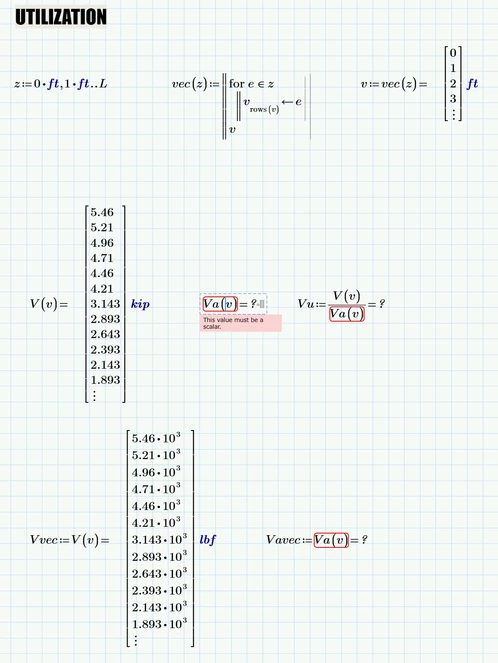

The problem arises when I want to find the specific utilization of the member along it's length.  To do this, I wanted to create a vector containing the input lengths instead of a range variable, so that I can perform math on the functions and output a vector.  This way I will have a vector of the members utilization along its length and won't have to manually check separate inputs.
As shown in the image above, the vector "v" works as an input into function "V(v)" but not in the function "Va(v)".  Is this because "Va(v)" is a piecewise function?  Is there a way to evaluate this function using vectors?

Your function are written for a single scalar argument x.
If you instead provide a vector as argument it may work well, but also can fail or return wrong results. Multiplications may be taken as vector scalar product and if you use comparison operators like in your function Va (eg. ..x<L/2) the function will fail as you cannot compare a vector x with a scalar L/2.

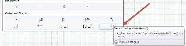

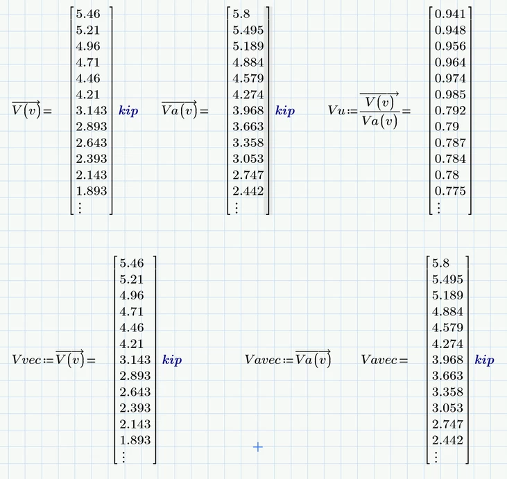

Solution is to use vectorization whenever you provide a vector as argument instead of a scalar and want the function to be applied element by element.
I feel its good style and you are on the save side if you use vectorization always when you call a scalar function with a vector argument, no matter if Prime would apply automatic vectorization (as in function V) or not (as in function Va).
Prime 10 sheet attached
