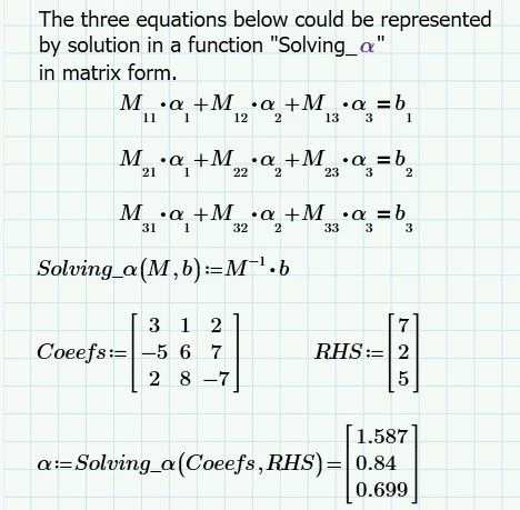

Is this what you are after:

Or, in one go:

Oh, you wanted the general case... Well, if M is:
and B is:
Then the three alpha's are:
