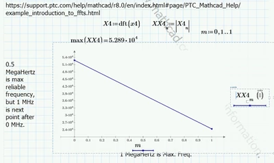

I have attached three files.  FFT1, FFT4, and FFT5.  I'm trying to learn how to do a fast fourier transform.  I begin with a 1 microsecond sampling rate, which provide a max. nyquist frequency of 500 kHz.  I multiply the number of points in FFT4 by a factor of 10, so the sampling rate becomes 0.1 microsecond, which provides a max Nyquist frequency of 5 MegaHz.  Then I again multiply the sampling frequency by 10 and produce a sampling rate of 0.01 microseconds and a Nyquist frequency of 50.  Can anyone take a look and confirm this theory?
How do I reproduce a segment of the output FFT?  I want to reproduce the segment above n=50 MHz in the final spreadsheet.
How do I reproduce the segment beginning with n=0 and ending with n=50 in the FFT5 spreadsheet.
I want to reproduce the original waveform as well..
Any assistance understanding this software would be welcome.
I also need to know what dft is doing relative to FFT.  I know it uses fewer points, are there any  deficiencies?
I need to know that what I'm doing is correct.

Your m is rows number. row 0 is DC spectrum. row 1 is fundamental spectrum ofimage.png

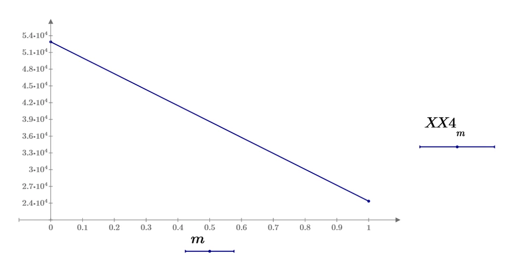

You aren't plotting against frequency, there are only two points in this plot:
You need to compute the frequencies for the ordinate axis.  Sample attached.
The "lollipops" are a stem plot,  (Look at plots/Change type.)
