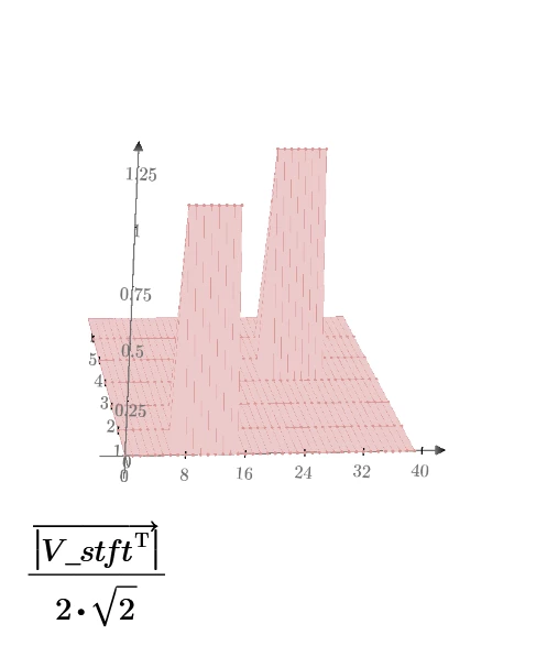

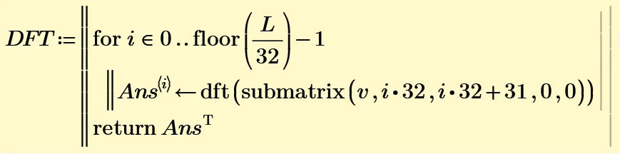

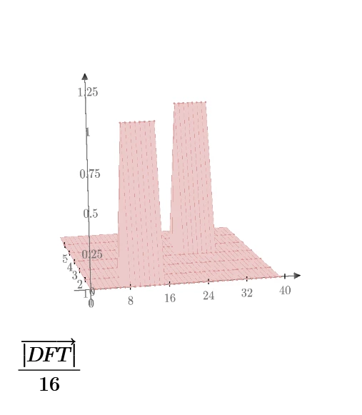

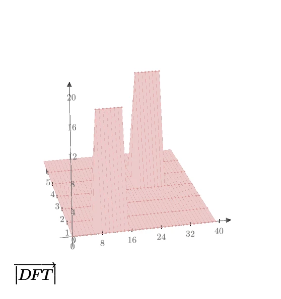

ttokoro
Aug 18, 2023 1:55 PM UTC
Plot data with dft and stft is almost same. The original wave has 1 for magnitude. dft for each 32 data must devide by 16. The one for stft must devide by 2.828. Never use w>0 for stft when you want to get real magnitude value.
