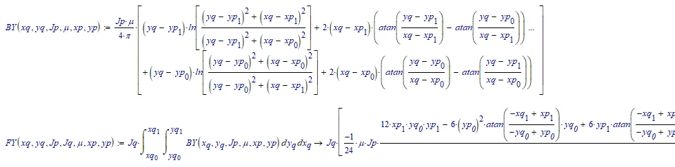

I am needing assistance integrating the attached equations. What I am wanting is a symbolic result of a generalized Maxwell equation for the force generated by the flux density. I have the flux density equations and the Forces (Fx,Fy) is the cross product of the Z cross Y and Z cross X components respectively. taking each independently and integrating twice will result in the the force.
What I need is the resulting symbolic equation.  my attachment only has the Fx info Fy is a similar result. What I am looking for from the community is some suggestions to how to break this down so it will integrate?

No need to 'break this down'.
If you want a symbolic solution, start by NOT defining any constants.
Here goes:
Note that the solution is pretty wide, I cut it off just before the end of the first of over 60 pages of landscape width...
