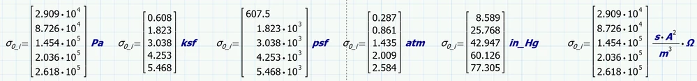

1.  at the bottom of page two, is there a way to delete the extraneous unit conversions (1/m * m * 1/ft * ft)?
Simply delete all units. Doing so will result Prime to display the standard unit which, if SI-unit system is preselected, is Pa. You may delete this standard unit and replace by whatever unit you like. You may even type a rather senseless unit (like Ohm in the picture below) and Prime will add other SI-units to make a strange, but correct result. You may also type kip/ft^2 instead of ksf or whatever you'd like to see here. But you have to overwrite all the units by the unit you want to be displayed. This is different to real Mathcad, where you type the desired unit in the box next to the displayed unit.
