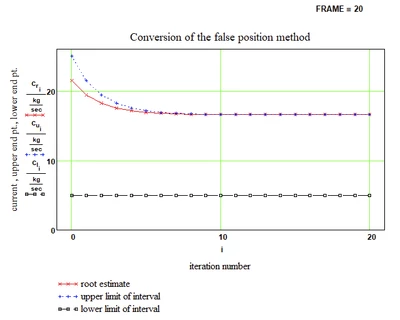

I wrote this file some time ago and I would like to think it worked.  Now I am being told the file can't be initialized.  I have left out something.  Help would be appriciated

I guess you are trying to create a small animation using 21 frames, correct??
I had no problem creating that animation.
Do you mean the error message "Error initializing video stream" after clicking the "Animate" button?
Chances are you forgot to select an area on the worksheet after selecting "Tools-Animation" and before clicking the "Animate" button.
BTW, I think you should change the axis limits so all calculated points can be seen.

thanks
