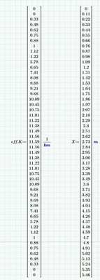

eff.K shown in picture is radius of curvature along beam length and X is the array for sectional points.
I have to double integrate eff.K to get deflection. How can i do it in Mathcad? Attached Mathcad 10 sheet.

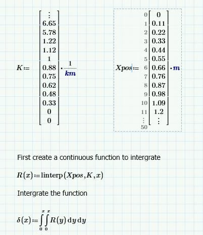

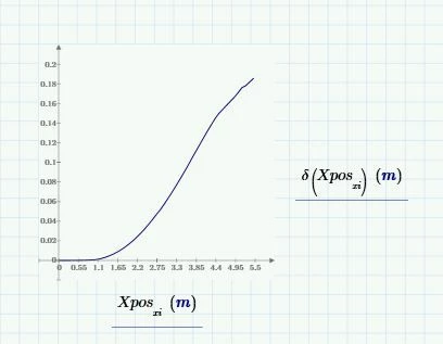

two steps.
1) turn the effK into a continuous function using the interp() function.
2) make a function to do the double integration.
Then plot the result
Terry, shouldn't your outer integration be with respect to x?
terryhendicott
Hi Alan,
If the second integral is wrt x it would be an area integration.  It should be two integrals wrt length along the beam?
To be meaningful for deflection of the beam the slope at the ends of the beam needs to be included?
Cheers
Terry

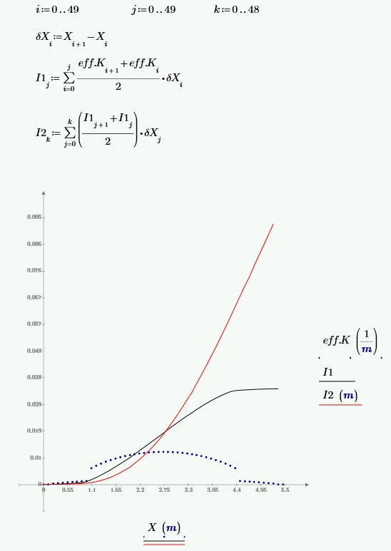

Here's a simple numerical integration:
