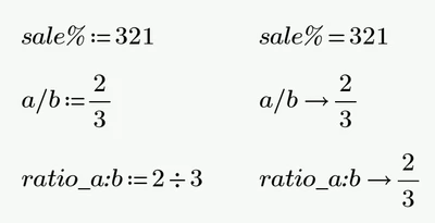

@dtrowbridge wrote:
Much thanks to Werner_E and 24-Ruby V.  That works just fine - forming a literal string and then removing the quotes - seems like this procedure sneaks the variable name past the scrutiny of an interpreter that is looking to handle the occurrence of typed brackets.
Yes, you can also create variable names like the ones in the pic below which otherwise would not be allowed to type in
