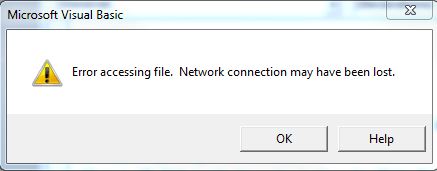

What happens is that I set up the GUI in VBA on Excel on Windows 7. The other user is still using Windows XP. The GUI works fine, however, when going into the development mode and trying to access the code to change the Interface then results in the following window popping up.
Even trying to open the file on the original machine now resuts in the same error. The first thought was that this is because of transferring the files between different machines. This seems strange to me. In my logic the Object is embedded into Mathcad file and should transfer with the MathCad worksheet without any link to another reference. The other option is that the interface is lost due to different version of VBA between Windows XP and Windows 7 (We are both on the same version of Excel). If this is the case the solution is to upgrade everyone to the same Windows version. This does, however, raise the concern as to how to carry models over to newer versions of Windows. If this is a problem it poses a serious risk for future use and therefore the method is no longer an option.
