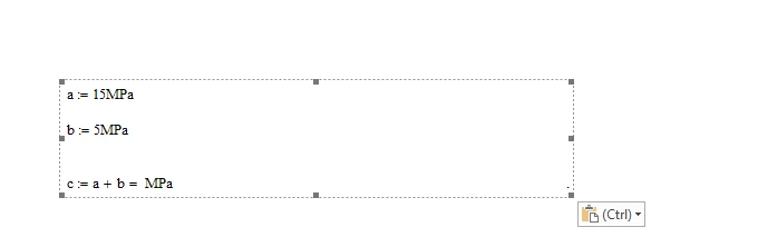

when I try to make a Mathcad15 object in Word, I do not get my calculations through.
(See image 'Word', my 'c' isn't calculated)
I already tried to reinstall Mathcad15 but that didn't work out. It's a very simple test calculation that doesn't go through. (see image)

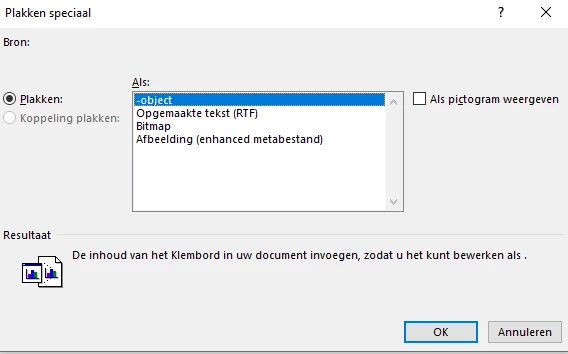

What I already noticed is when I use 'paste special' it doesn't show 'Mathcad object' but just 'Object' and I can't make an object link, but no idea if that is part of the problem. (see image) I also want to make it a link so I can refresh these calculations in my Word file.
There are no issues on my collegues PC.
Anyone had a similar issue or has a solution?

23-Emerald V
Are you and your colleague using the same version of office?
Note that mathcad 15 predates Office 2016...
