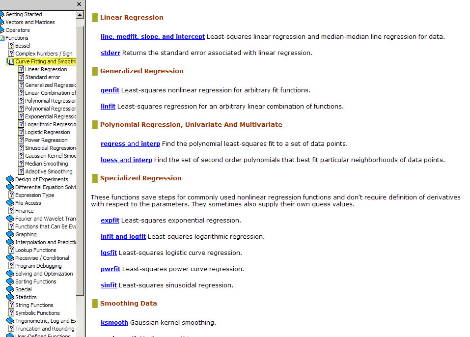

Is it possible to get an equation for a graph  similar to the function of excel "Trendline" in Mathscad? I would like to get the equation for differentiation purpose. Thanks
March 10, 2016
Lookup the the various regression possibilities in the help under "Functions/Curve fitting".
More information cal also be found in the "Data Analysis E-Book".
