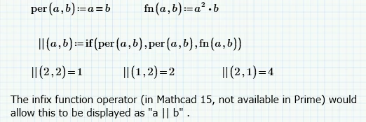

Mathcad (or at least as I use it) doesn't have functions that return logical true/false.  How about
playing games:
