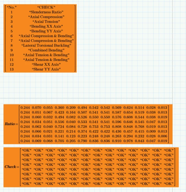

Looking to provide a sequence number above both the ratio and check matrices, see attached image, to correspond with the check list above.
I work with Mathcad Prime 10.
23-Emerald V

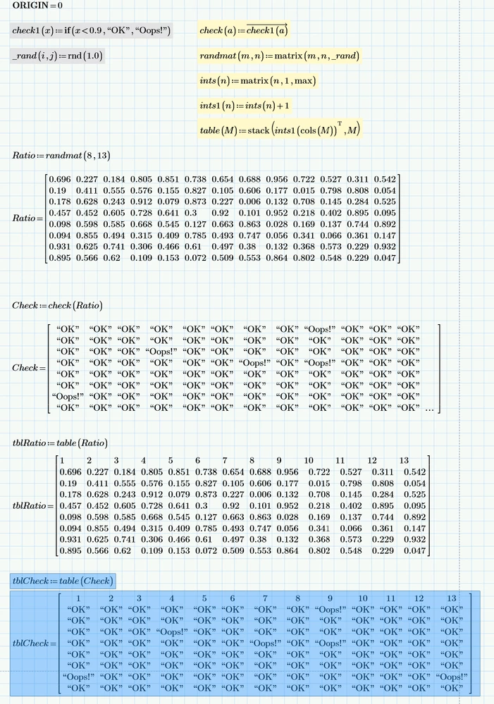

Do you mean something like this?

Yes, that looks like what I am going for, thank you Stuart!
23-Emerald V
No worries.
Please find attached the worksheet I forgot to add last time.
