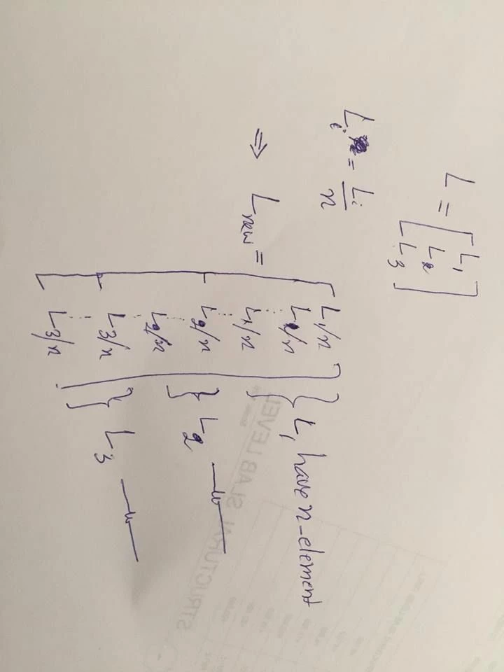

Dear Everyone,
How can I Create New Matric by divide Matric element by n-element (as attachment)?
Many thank for replying.
Best regard
Phearun
Intial ElementIntial Element
the Purpose of Quesrionthe Purpose of Quesrion

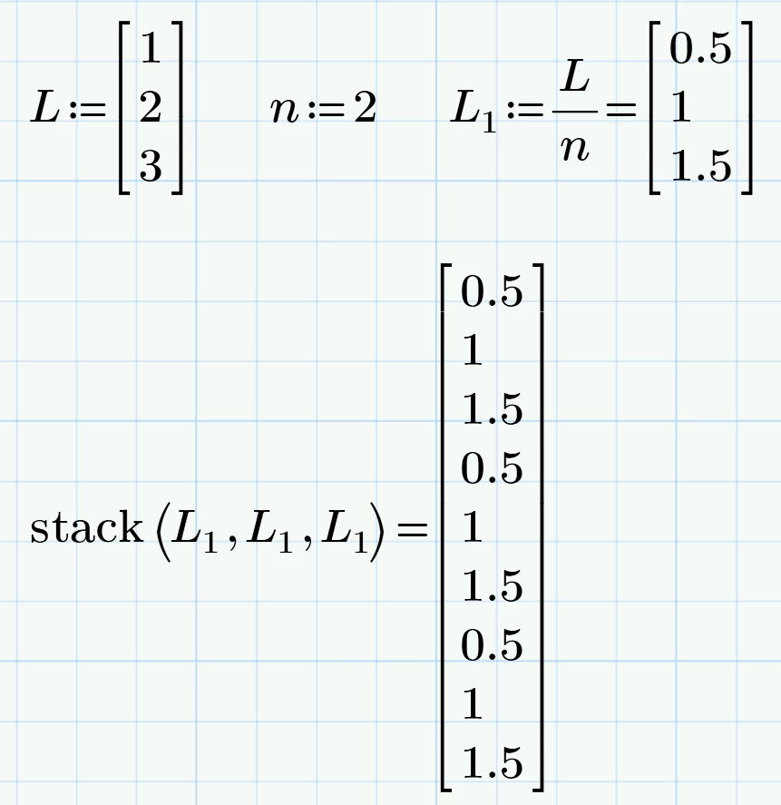

March 16, 2018
May be so:

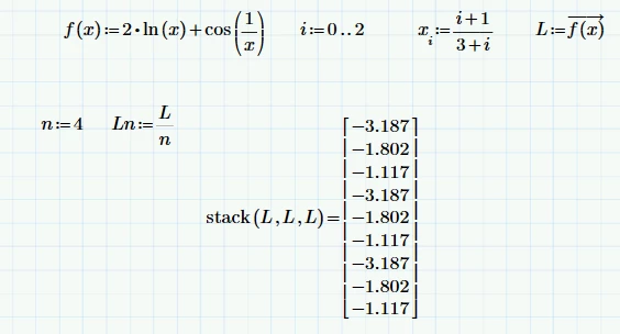

March 20, 2018
I'm not sure what you mean,
@SPRstructur wrote:
We can not us stack()  because L is from other calculation
You certainly can stack answers from calculations:
