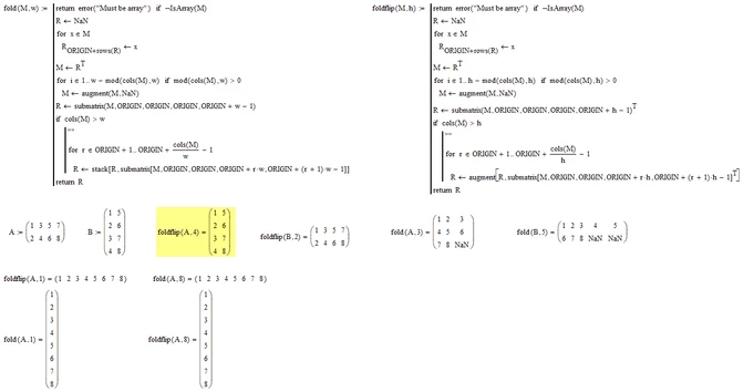

There are so many ways to achieve this simple task.
As Luc already gave you the functions "fold" and "flipfold" in the course of a similar question, I modified his functions so you can also use them for the new problem:
Worksheet in MC11 format attached
