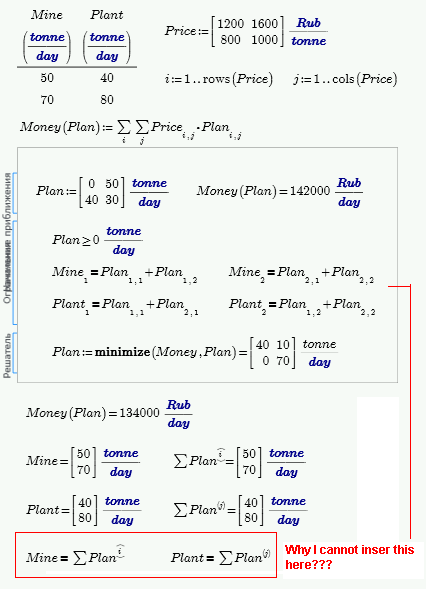

Hi Valery.
Attached, some modifications.
Best regards.
Alvaro.

Hi Valery.
Linear programming usually involves a lot of individual equations. It could be some frustrating if you must to write one by one.
Hope that this arrange works in Prime.

And maybe this other arrange could be more clear.

Thanks, Alvaro!
1. Attach please the sheet.
2. My students and me would like to solve this Transportation theory (mathematics) - Wikipedia, the free encyclopedia
in general in matrix form: we have k mines, n Power plants (two vectors) and a k*n matrix with Price of transportation of coil. Some elements of matrix have the value infinity - no way. What is the optimal Plan?
3. How can we use summation in the solve block in this task Solver Mathcad 15 and Mathcad Prime
Val
