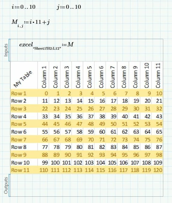

September 4, 2021
It is possible using the Excel Component where the formatting is done in Excel for a much larger formatting set.
For example:
Cheers
Terry
