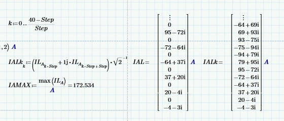

Although, if I had Prime, I'd probably program a function to do the sampling.

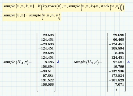

As I've only got Express, I'll have to define a recursive function to do the job.

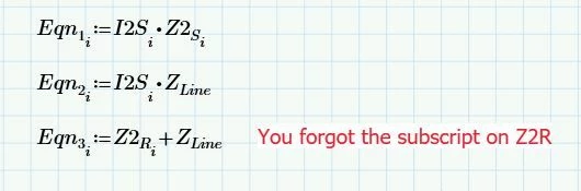

You forgot a vector index "i" when you defined Eqn.3

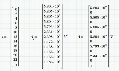

Are you aware that all your vectors have every second value set to zero?
You don't see this when you type A[i= but you can see it when you simply type A=
The reason is that you defined the range "i" which you use to create all your vectors with a step width of 2. That way only elements with even index are created by your calculations and vector elements with odd index are automatically set to zero. Not sure if thats really what you intended.

Try something like the following, perhaps?

You missed a subscript
