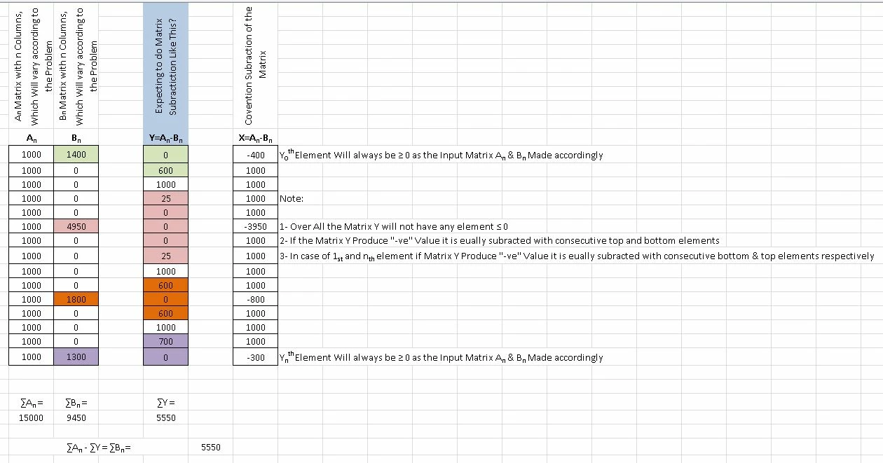

I have two one dimensional matrix An & Bn
n= No of column of the Matrix
Please see the attachment, which is quite easy to understand what I want to achieve
PS I am using Math CAD 14

April 19, 2015
Not to me. I understand how you get 0 as the first answer, and 600 as the second. Please explain the logic you use to get 0 as the third answer. It looks like this was calculated in an Excel spreadsheet, in which case please post the spreadsheet.
rjaison1-VisitorAuthor
April 19, 2015

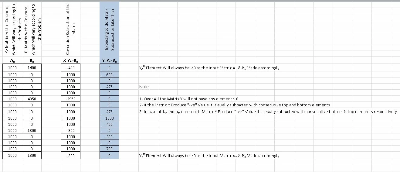

I am sorry I made a terrible mistake
Please see the attachment "Complex Matrix Corrected"
BR,
J.Randeep
May 4, 2015
Hi Everyone,
I am still struggling with this Matrix Complex Subtraction
I am thinking it is more like a Boolean Subtraction, but I couldn't figure this out though.
May be somebody comes up with a genius solution !
