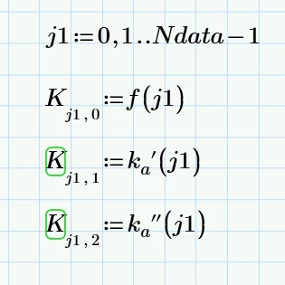

I defined a matrix as a result of computations performed in my code, where three columns have been filled with frequency (in Hz or sec-1), and the real and imaginary part of a wave-vector (k' and k'') and several lines (801).
I was firstly surprised to see that if I define each column in a loop I receive back the notification that the variable has been "re-defined". The loop is below, with green-circled matrix element that receive this comment
In spite of this, the matrix is correctly filled, as I check by using  the statement "K=".

Unfortunately you can only export data without units. The matrix must be dimension-less, scalar values only!
You can use something like
to strip the units. You have to use vectorization and be aware, that Prime would use the standard/default units only, not the ones you may have used when your values were defined (12 min would end up as 720 in the file).
