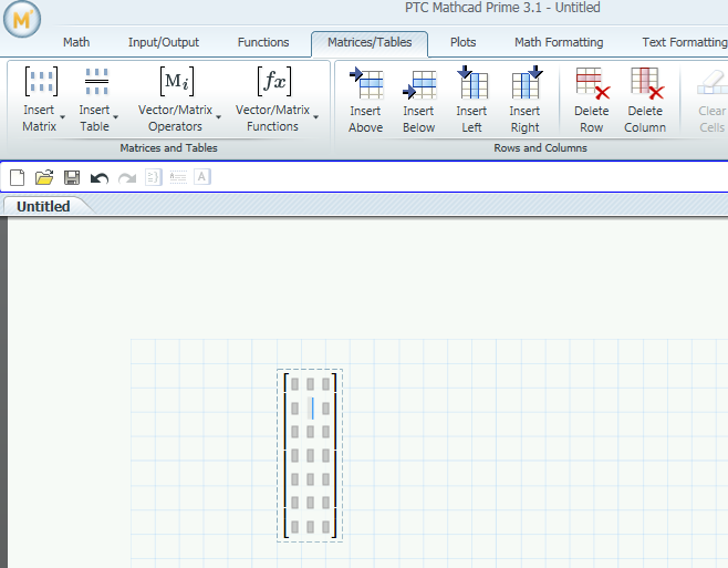

Best answer by DJF
You can add rows or columns under the Matrices/Tables tab.  Or, a shortcut for more rows is Shift-Enter, for more columns Shift-Space.
DJF16-PearlAnswer
June 16, 2016

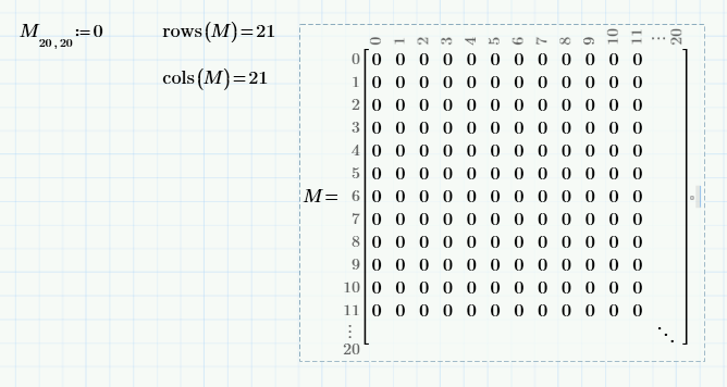

There is no problem in creating large matrices, even with millions of elements, It's just that the user interface for creating a simple matrix is limited to 12x12. But you can do as follows:
Now if you copy that matrix to the definition of yours, you can fill it up.
June 16, 2016
They must have figured that no-one is going to fill up a matrix larger than 12x12 by hand. They may be right. Generally you would have some kind of recipe or algorithm to define the matrix elements. Basically that's what I used to create the 21x21 matrix, by defining just the bottom-right element.
