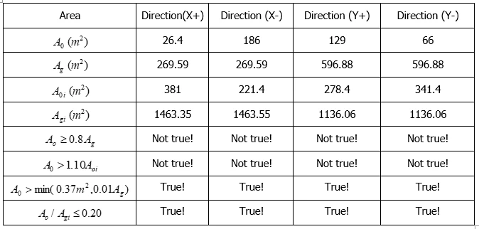

Could you help me please ? How to write this equation in Mathcad Prime ?

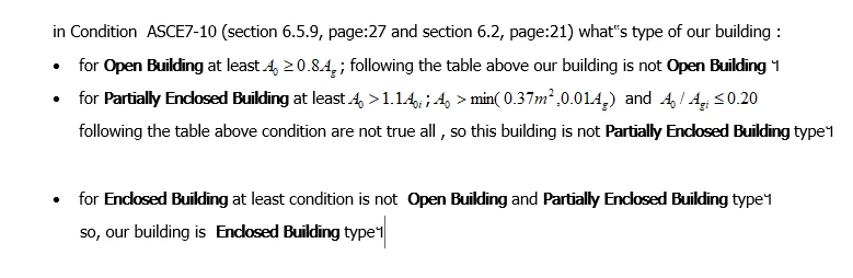

Thank you for reply , Mr./Ms. LucMeekes,
i want to write equation have condition like that.
following table as previous, thank you so much.

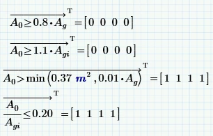

You can vectorize Boolean comparisons
Prime 4 attached

 Hi Mr. FredKohlhepp
I'm really thank you for your help me. i respect you for your kindly shared me.
