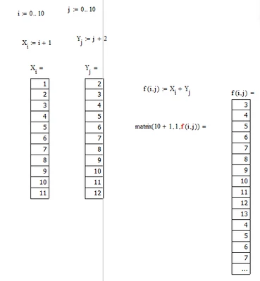

I am a little confused about the matrix (m,n,f).
I don't very understand what's the role of f in this function.
I try to use this function to do some tests, but I still don't understand why I will get these results.
I don't define the i, j but the Matcahd can do the calculation.
Can someone use an easy example to explain this function to me, it is hard for me to understand it.

Hi @LucMeekes
Can I only use max(i,j) or min(i,j) in the matrix() function?
Could you use another example of how to use this function?
May I know why this example can not work?

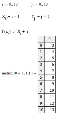

When it comes to the problem you show in your picture, I cannot duplicate the error. The result is as expected the vector X increased by 2, the first element in matrix Y.
To find out what the problem on your side actually is, you would have to attach the worksheet.
EDIT: Ah, I see! While its usually better to attach the worksheet in question, the problem you experience comes from writing "f(i,j)" instead of just the function name "f" when you call the function matrix.
