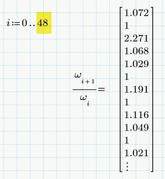

As your vector omega consists of 50 elements, the vector of quotients obviously can only consist of 49 elements.
So the job could be done that way:
or even better using

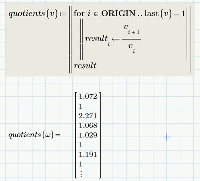

If you need that kind of calculation more often it might be beneficial to define a function:

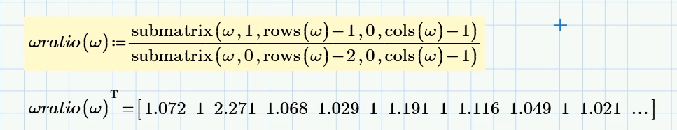

Or for the Express users amongst us (and it will work in Prime), use Mathcad's submatrix function:
