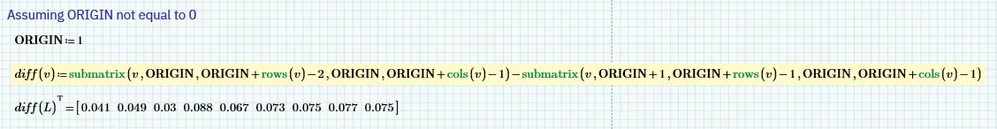

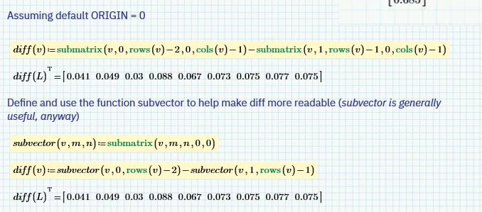

Here's a functional version that should work in Mathcad Express
Using ORIGIN = 0 makes life easier:
But if you have a different ORIGIN, ...
A programmed version would be more compact (and easier to read!), but I don't have a full Mathcad Prime at the moment.
Stuart

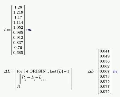

Mathcad Prime 8 version attached.

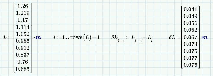

Jun 1, 2022 1:41 PM UTC

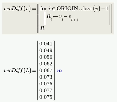

Here are my 2 cents
Its more versatile to use a utility function, especially when you intend to treat more than vector that way
