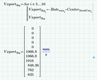

Matrix multplication with mid-range indices yields zero values outside the range
I have imported excel data and made column vectors from data. When I try to multiply elements with an index beginning somewhere in the range I get this.
Why do I get zero values and how might I eliminate this behavior?

By default vector indices start with  number 0 and if you assign the vector element 5 a value, you are actually creating a 6-element vector. Elements #0 to 4 are set to 0.
So you might use index i-5 instead of i on the left hand side when you assign the multiplication result.
Other solutions like the usage of the "submatrix" function or the "trim" function are possible, too.
Furthermore you should move the return of the result from inside the loop to after the loop - it works the way you did, but its not good programming habit.

You could also  change the index starting value, it is controlled by the built-in constant ORIGIN:
But you probably shouldn't...
If he does so, he would multiply the wrong values! He would have to use index i+5 instead of i twice on the right hand side of the assignment!
So I sure would vote against changing ORIGIN to 5 😉
A better option may be to trim off the first five entries in the "Row" and "Center" vectors right ahead and then use a vectorized multiplication of the two. But without seeing the sheet and knowing the reason why the first five values in the vectors should not be used, we can't say for sure if that really is the better approach.
