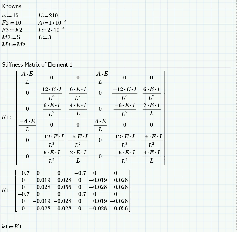

I am having multiple issues with matrix operations in an FEA assignment.

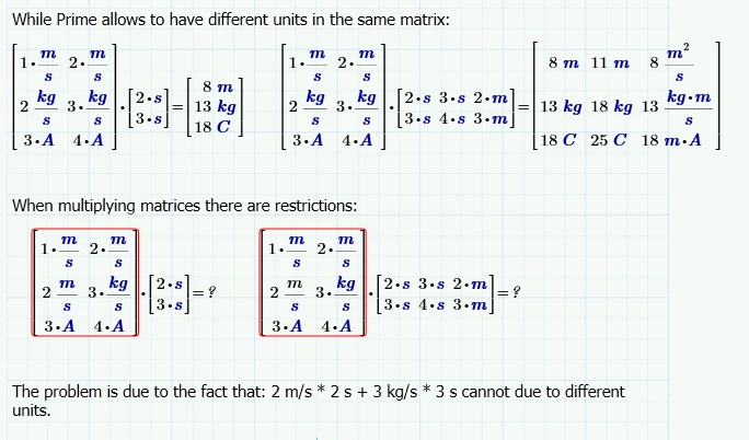

The first was multiplying a transformation matrix by a stiffness matrix, I got an error stating the units were incompatible.
Removing the units from everything solved this.

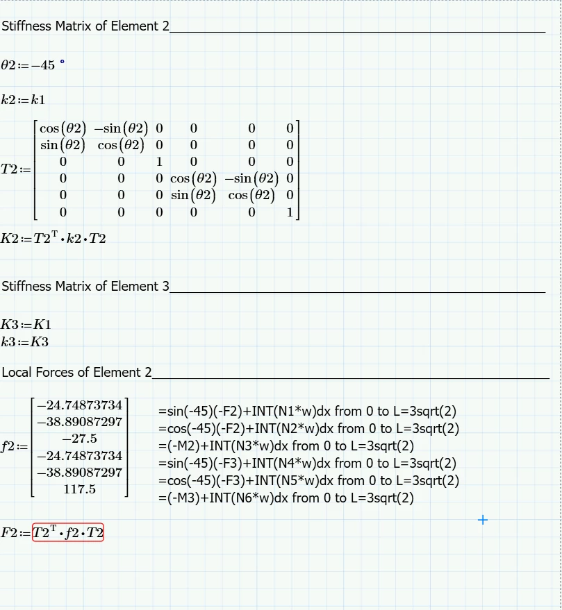

Now I cannot get the local forces to transform into global.
I am unable to attach the file because this website says the contents of the attachment do not match its file type.
I will attach a screenshot instead.

And to answer your first question:
23-Emerald V

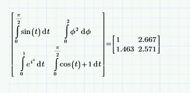

And here's an example of integrals as matrix elements:
Thanks a ton!
My units issue was definitely because of the unit less 0's in the equation.
And the integration issue I solved by integrating outside the matrix and the plugging that value in.
But I did learn a bit from that graphic too!
