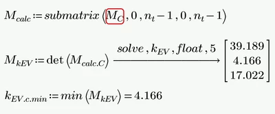

BTW, you could create the final matrix also with the "submatrix" function, as M.C already is the full 4x4 matrix.

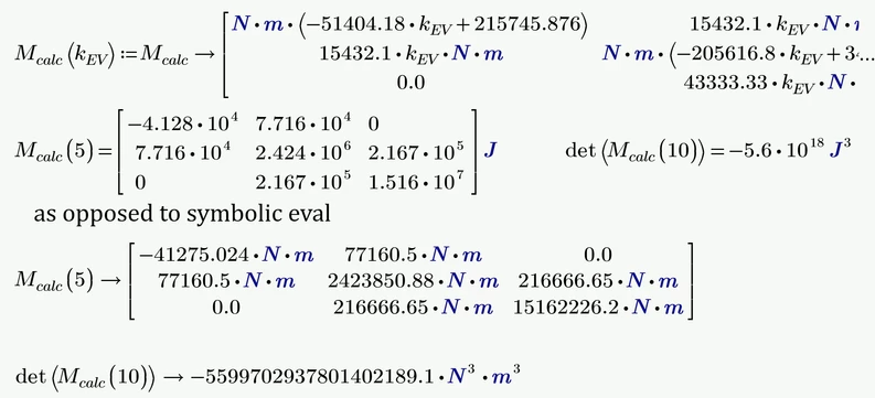

The red error can be avoided if you follow the definition by a symbolic evaluation
In case you need to see the matrix and its determinant for certain values of k.EV and would like to use numeric evaluation (maybe because of unit simplification), you may (re)define M.calc as a function (symbolic inline evaluation is mandatory here):

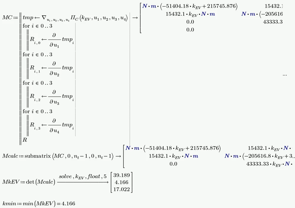

I conclude there's no "elegant" way to combine the partial derivation + the loops + the matrices. However, you pointed me to idea of a straightforward definition of the matrix as follows :
Including the symbolic evaluation to avoid the red tags.
Then I'll use a "for" loop to resize it as per the targeted level of precision, which works.
Not as short as I would have wished, but fair enough for me.
Thanks again!
Using "submatrix" as show above instead of the nested for-loops makes it a tiny bit shorter.

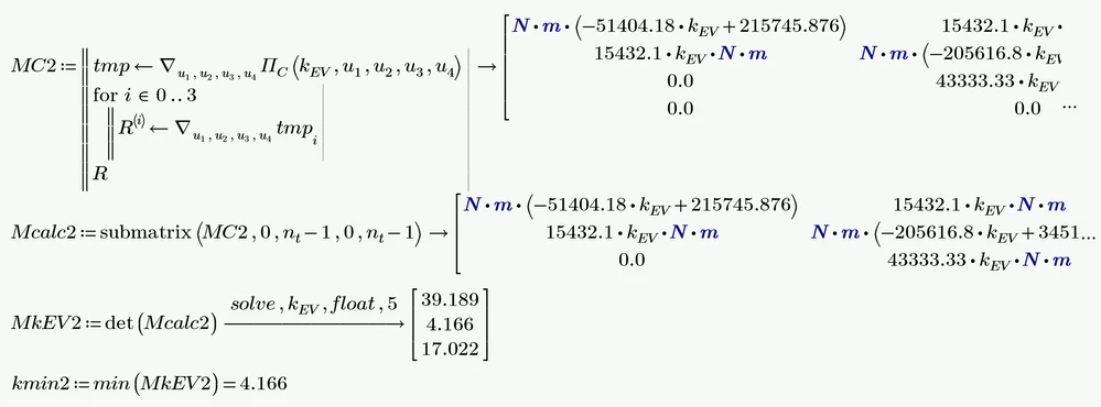

Here is version which makes calculating the full 4x4 matrix a little bit easier using the gradient (Nabla) operator.
Could not find a way to eliminate the repetition of the second derivatives.
The approach does not make advantage of the symmetry of second derivatives (theorem of Schwarz, Clairot, Young).
Prime 11 sheet attached
