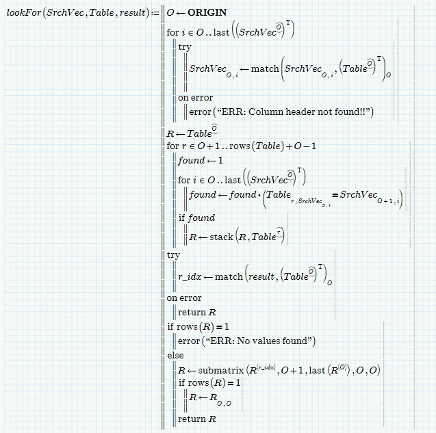

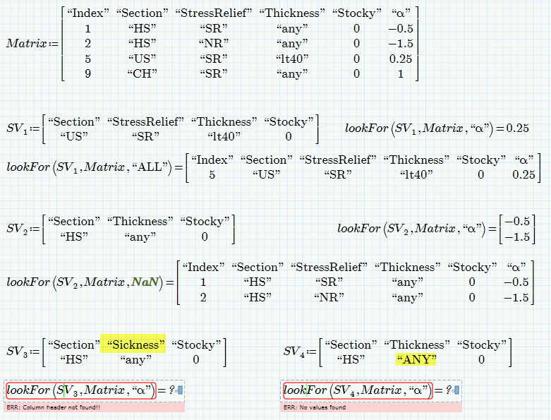

Maybe you are looking for something like this:
Some rudimentary error handling implemented.
If the last argument is a valid column header, just the value(s) in that column are returned, otherwise the full rows.

Hi Werner,
Many thanks, I'm currently thinking my way through  the method supplied - the matrix math its relatively new so it might take a couple of goes to absorb it. The error handling is good, till now hadn't thought much about that.

Peter Darby wrote:
Hi Werner,
I tried to provide a more general utility which works for any header expressions and any type of table values. That way it looks (and is)  more complicate.
Feel free to come back and ask if you experience any confusion.

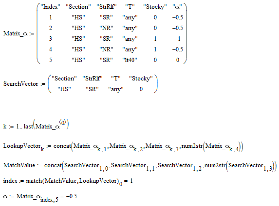

How about this?
For clarity, here are the values of LookupVector and MatchValue:
This is shown in Mathcad 15, but I believe everything would be the same in Prime.
You could also turn this series of calculations into a program for ease of use.

November 23, 2016
Hi Mark,
Thanks, like the concat - it really strips down the logic - I'll try it in prime and see how it goes.
