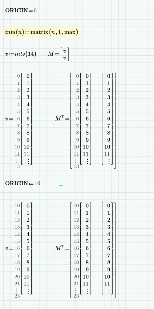

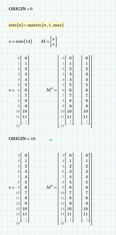

While looking in Mathcad Prime 10 at a worksheet whose ORIGIN = 1, I noticed that with Show Indices turned on, a nested array's indices ran from 0 to rows()-1.
I tried to recreate the effect in a blank worksheet, but to no avail ... until I changed ORIGIN without recalculating the evaluated variable.  I initially set ORIGIN = 3, then changed it to 10.
Pressing F5 caused the indices to reflect the change in ORIGIN.
Equally interesting, I saved the worksheet after changing the ORIGIN definition back to 3 (with the indices showing 10..23) and reopened it.  This time, the indices ranged from 0 to 14.

I can confirm this undesired behaviour.
Furthermore I noticed a discrepancy when using the global/worksheet settings for "Show Indices".
When a matrix is displayed these global settings are used and when I click in an empty space in the worksheet and change this setting, the changes are reflected immediately. But when I just resize the matrix, again click some empty space and change the global settings, they don't show any effect anymore. Thats sure not as it should be.
