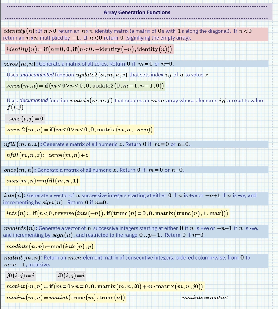

Terry's is the simplest method.  However, Express users might find the following helpful if they want to create a zero matrix of arbitrary size.

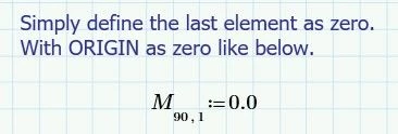

To create a matrix with all zeros as Terry had shown you simply have to assign the element in the last row and last column a value (maybe zero as well).

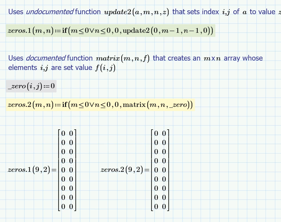

Stuart showed other methods to achieve the same effect.

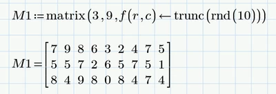

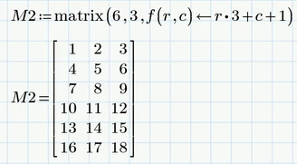

To create a matrix with random numbers you could also use the "matrix" function
Or fill the matrix row for row with consecutive numbers

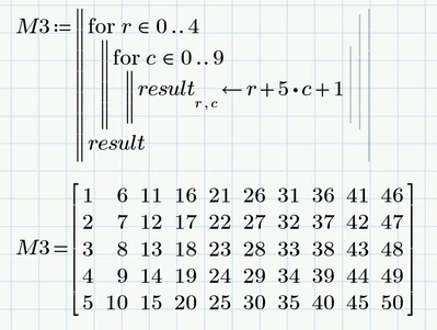

And of course you always can resort to classical use a program with nested loops to do the job

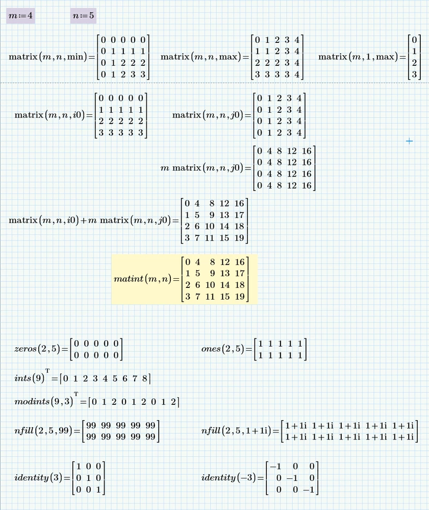

And for those watching in Mathcad Express:
And a brief explanation of how matint works.
