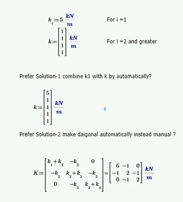

You could use the "stack" function for your first problem and for the second you could write a custom function to create a matrix to your specifications.
BTW, its always better to additionally attach the worksheet itself additionally and not just post pictures.
May 3, 2020 3:00 AM UTC
Thank u
please find attachment file
