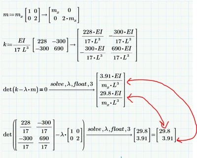

Matrix terms are reversed when evaluated symbolically
when evaluating frequency equation for a MDOF model, if the stiffness and mass matrices are defined in terms of mass, elasticity, and etc constants, the resulting terms of the symbolic evaluation are reversed. (see below). I know that the result in terms of the constants is the correct answer. However, I dont understand why the determinant using values only gives reversed terms? Any ideas or pointers are apprieciated.

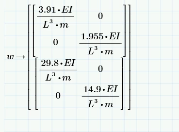

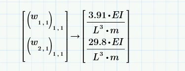

correction: Im not sure which is the correct answer. when solving the equation by hand the roots are as follows
MI_10648350_1-1680899010138.png which Im assuming the correct answer. Also the matrix terms are as expected
MI_10648350_2-1680899172356.png However, when solving it in terms of the constants EI,m,L. The terms are as follows
MI_10648350_4-1680899685201.png where

Werner_E25-Diamond IAnswer
Apr 7, 2023 8:59 PM UTC
I see no problem here.
There is no rule or convention about the order in a set of multiple solutions to an equation.
Its quite possible that the symbolics returns the solutions in a different order depending on if just numbers are used or variables & units.
As we don't know how the symbolic "solve" is implemented internally we can't say why.
WHY IS MATHCAD GIVING ME a DIFFERNT result than expected?
Mathcad gives you a correct result - it can't know what you expect 😉
Apr 7, 2023 10:25 PM UTC
Thanks Wener_E! it seems logical. It was my initial thought, but what about the embedded matrices? I cant make sense of those extra terms?
