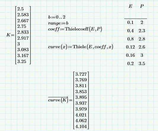

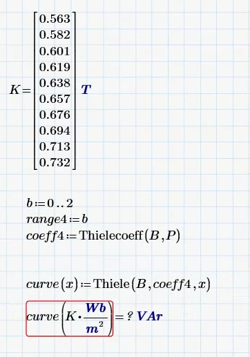

Hello everyone,
I want to K matrix elements as inputs on my curve formula so I can get output of my K values. MathCAD says that "this value must be real.", when I write K as an x variable's value. Can you help me about this topic?

Hi
Function curve has last parameter as a scalar.  It is not set up for x to be a vector.
It is thus necessary to vectorize the call to curve so it is given one scalar at a time

Thank you for your respond. Curve function need to real values as an input, but at K matrix I have real values. So I think I can be able to use these values but doesn't allow me to use values. I want to results of K values in curve function.
