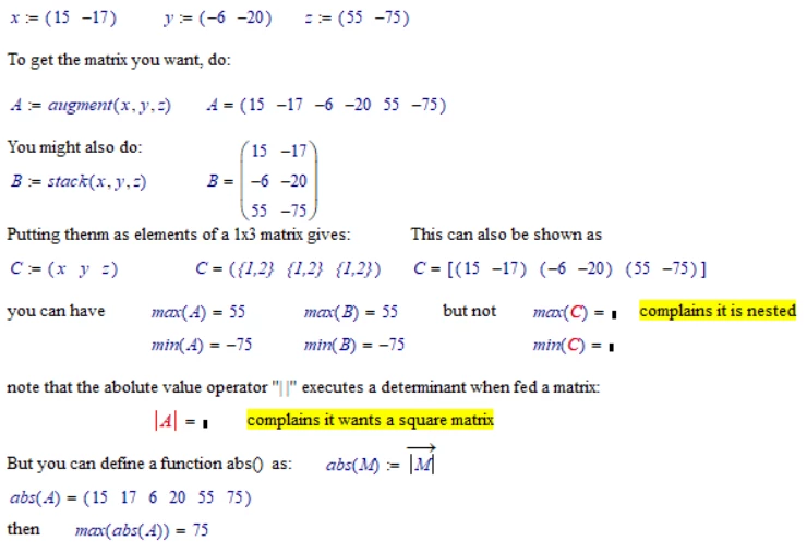

Best answer by LucMeekes
Use
A:=augment (x,y,z).
Then the Minimum of your matrix A will be found with:
MinA:=min (A) = -75
To find the Maximum absolute value use:
MaxAbsA:=max (abs (A))= 75

Use
A:=augment (x,y,z).
MinA:=min (A) = -75
Some more:
